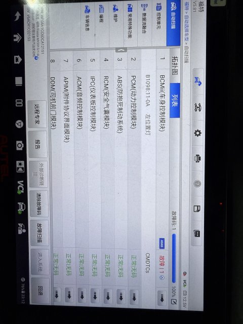

Hello ,I have a fiesta ST in china ,I love it very much ! but i got problem this days
My BCMii have a fault :B1098:11-0A Left Position Light
I have no idea where the problem is ,i have check my light and every thing is okey
pls help!

That code is telling you there's something wrong with the left side light circuits. It is commonly due to a defective lightbulb in the taillight cluster, though breaks in any left side light wires or corrosion in connections can also cause it.
