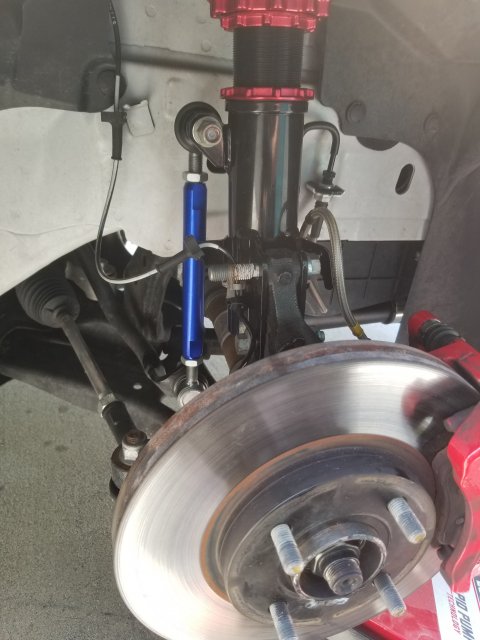

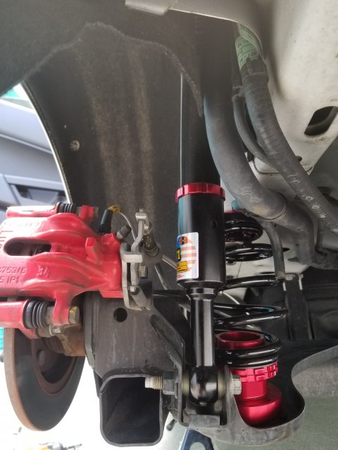

I've had these on for a few weeks now, just wanted to give my initial thoughts. Jerrick suggested I go with an 8/6 setup which is what I went with (hes WAY more knowledgeable than me, so I will.always take advice from someone smarter than me). I havent been able to get them on the track yet because of this whole Covid debacle, but I have done quite a few late night mountain runs, and when I say "runs".....I mean quick runs (1.9 lateral g's).
Dialed in at the stiffest settings it is too stiff for DD, and might even be a bit too stiff for a more open track, but would prob be really good on a short track or AX. On the softest settings the car rides way better then stock. Its firm, planted, but still floats over bumps and joints. So far the only negative that "might" come out of these, is that the car seems to have a little more body roll. It is prob just me or a placebo effect and just need more time dialing in the settings. It still needs to go back in the shop to have it re-corner balanced as well. I'll edit this post once I get that done as well as some track time (which may be sooner than later if we can rent the whole track).
-The rear spring bushings were replaced with Powerflex black/race bushings when installed as well.
-SuperPro end links
-rear ride height is set 1/4" lower than the front
-front ride height was set by eyeballing for the correct roll center
-MINIMMUM camber I could get was -3.4* front, but that was with H&R camber bolts as well, and -2.2* for the rear. (Coilovers were installed with max camber from the top hats).
(All these preliminary adjustments will be re-done and fine tuned once I can get the car back in the shop and up on the rack.
Overall, these coilovers are definitely worth the money. Jerrick has been nothing but helpful, supportive, and accessible thru the whole process. Definitely a stand up guy!!!

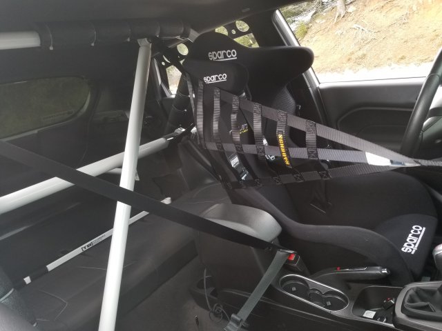

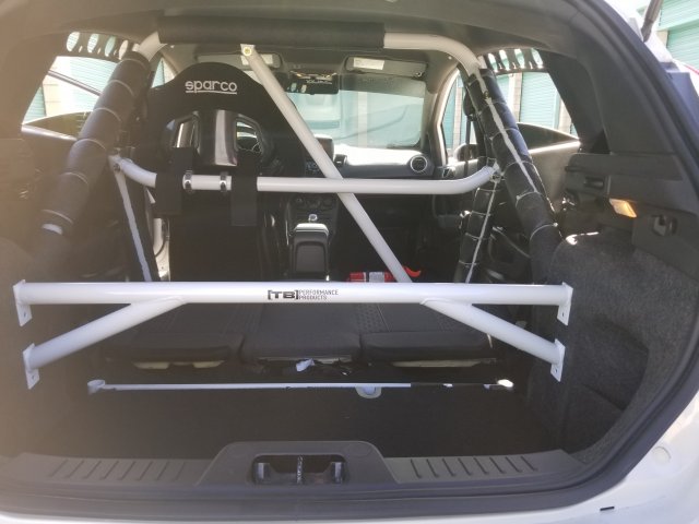

Here are a few pics

Any particular reason you put your rear springs/perch installed upside down?
I've seen coilovers installed both ways. Spring perch at the top, and spring perch at the bottom. I'm not sure it makes any difference, especially with a linear rate spring. With the spring perch at the bottom, it makes adjustments alot easier. Maybe I'm wrong tho, please let me know.
