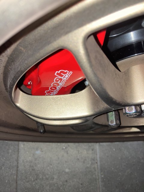

I picked up the 300mm (16" wheel size) bbk, planning to run under 16x8 rpf1s from Oakos. I also picked up 10mm H&R spacers/studs. Should that be enough clearance to fit the calipers? Also debating buying new hubs/bearings to swap the studs into new hubs off the car, figured it would be easier and a good preventative task. Any thoughts on this?

You should be fine. Im currently running the 16x7 rpf1 with a 15mm spacer just fine. Seems like there is maybe 3mm of space. 16x8 has more offset than mine. Think you are 38 and im 43. On the flipside i just bought dekagrams and trying not to run spacers lol still searching here for info

yes it does as it can help with clearance. D-Resonant has the Whoosh kit and we checked my 16x8 +40 offset Dekagrams with the 300mm kit and they would need a 5mm spacer. You should be fine with the 10mm spacer.

so the larger the number is for the offset the more the wheel tucks in. Since you are 38offset and im 43off set you stick out more by 5mm. So your 10mm spacer will work

Yes the more positive offset the more ones wheels are tucked. You do have to take into account that his wheel is also only 7 inches wide which means less backspace overall front to back. So he may need more spacer depending on the spoke design of the wheel. This why Ron and most big brake manufacturers either send you a measuring cut out or have a link to printing out a measuring cutout for this very reason.
It eliminates all the back and forth guessing games.

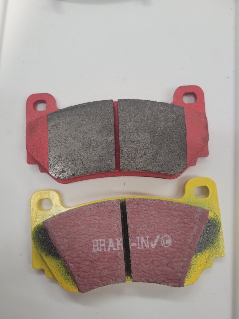

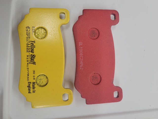

Swapped out the pads for EBC Yellowstuff with big help from @EBC Brakes UK
Here are the part numbers that fit this kit - DP41377R (Yellowstuff) and DP51377NDX (Bluestuff) - @ron@whoosh might be worth it to add these PNs to either the BBK page or even just start stocking them!
Note that I didn't buy the Blue stuff but I assume this part number is correct. I didn't even drive on the Red pads but I knew I wanted something more aggressive anyways.

thank you
Yellowstuff will be added to the site
2 in stock at the moment $69.90 + shipping

Diameter-wise you should clear fine, it's just the caliper clearing the inside of the wheel spokes that you might have an issue with. You can use spacers as others have done, but for myself I wouldn't want to use them, but I don't think Ron has a caliper template he can send so we can check for clearance.
