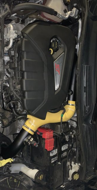

Can you post up a photo of the install/your engine bay? Did you reconnect all the evap lines that might have been disconnected during install?

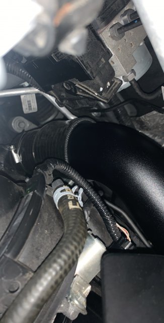

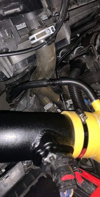

I'm going to say the issue is the hose connected to the yellow tube. What did you do to the factory evap hoses?

Factory EVAP hoses don’t work with this intake. So I made a custom hose.
You're going to find out that doesn't work.
Those evap hoses are designed a particular way for a reason you can't just cut them up and expect it to work.
Many companies have tried to make an adapter for this and most of them fail. I think only one has been successful with it. Most people either don't replace that tube for that reason, or they install the line set for a 2014 to 2015 year.

from the pics, your car is a 2016-2019 which means you have a dual line evap system vs the single line from the 2014-2015 Fiesta ST's
you'll need one of 2 things to correct the issue , the Ford evap harness or the whoosh evap fix kit. I strongly suggest using the Ford kit as it's an OEM and 100% cure for your issue (both are found in the intake section of our site)
In the meantime while you decide which route you'll go I would simply swap back the OEM induction hose and connect all of you evap lines back they way they were. The whoosh crossover and short ram intake will connect to the OEM hose
