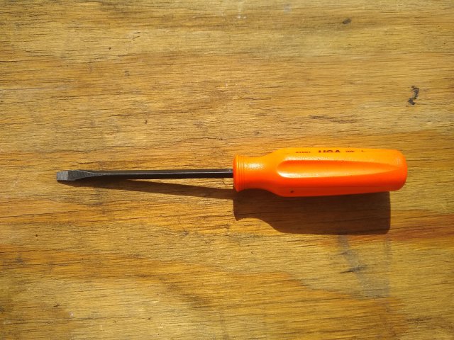

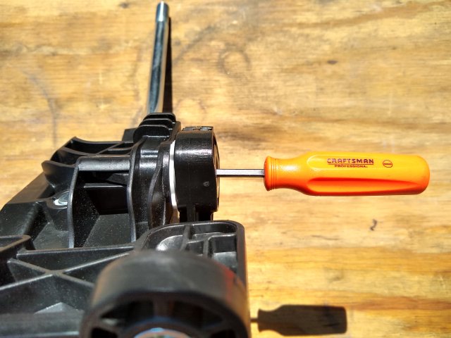

1) removing the side plate: seems a lot of broken clips result from this step. Key is using a small screwdriver exactly as pictured, shape of tip is critical. Simply insert driver into center bore until you can see the tip, this will release the clip, no prying required.

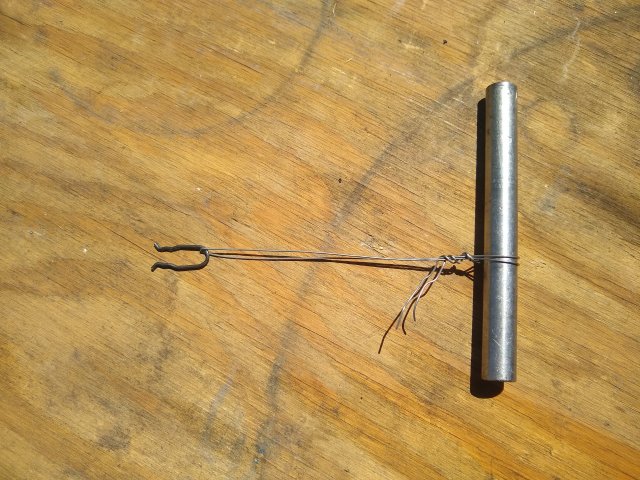

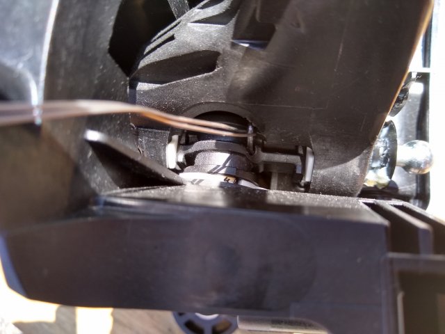

2) removing the spring clip: when you look at it, first impression is no way that clip is coming out, it's clear that assembly was not designed to be taken apart. It will come out though, just have to pull on it really hard, clip is spring wire and will distort and pop out. A really robust spring hook tool should work, mine wasn't and started to bend so I resorted to the safety wire wrapped around a handle trick. Stand on the assembly and pull.

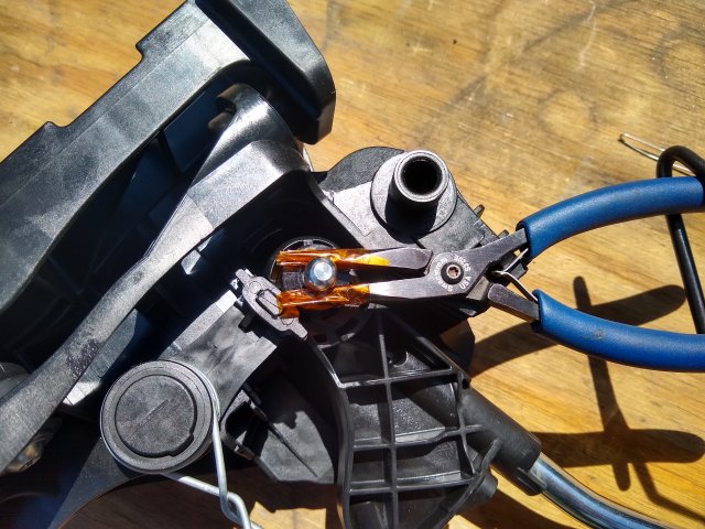

3) tape your needle nose: tape your pliers tips or you will scratch the ball end on the pin.
