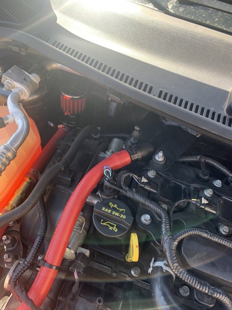

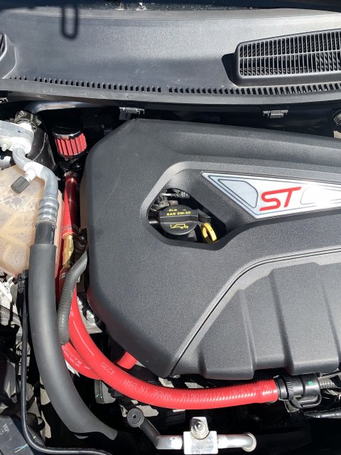

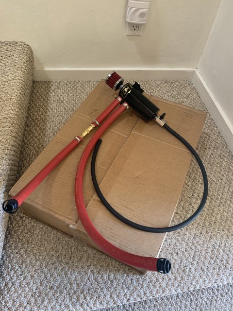

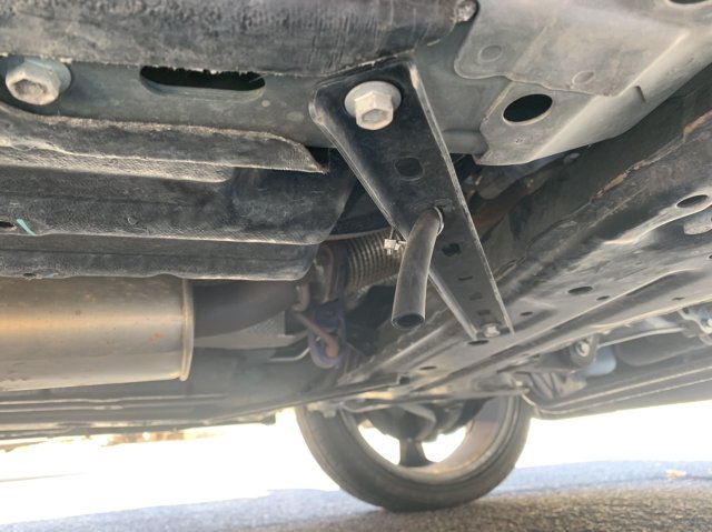

I just installed mine today and Iā€™m happy so far. Itā€™s nice to finally have some color in the bay! I went with the higher mounting hole for the bracket which moves the can lower, assuming I needed that space for the VTA filter. Itā€™s more stealth for sure, almost think I could have got away with the higher mounting location.
A couple tips on the install. IMO the directions should call for a 10mm spanner wrench, not a socket. Thereā€™s no room for a socket between the can and the mounting stud. Also youā€™ll need a 13mm or 14mm wrench or deep socket to install the plastic hose barb at the bottom of the can underneath the drain valve.

^^^I may try to route my drain hose that same way, into that brace, instead of looping it up out of the way, and then having to fish it out every time I use the drain. [:)] [thumb]
