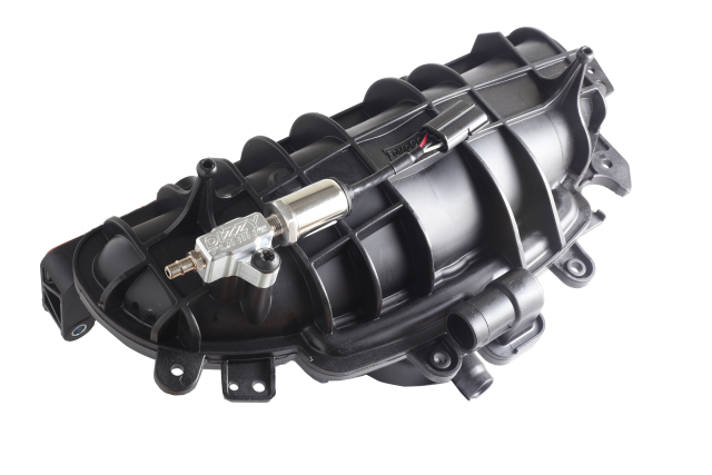

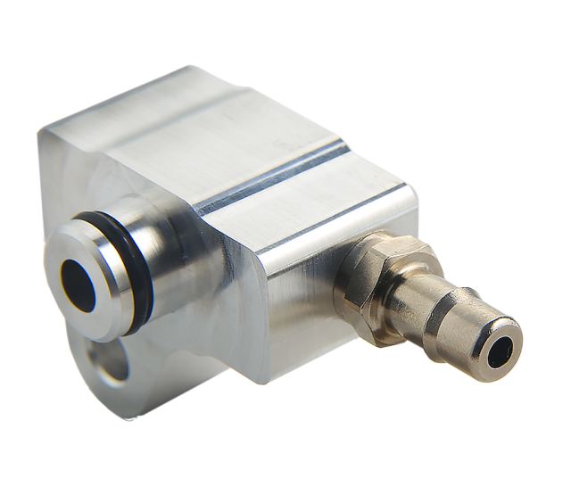

How do I install the new MAP Sensor? This adapter will fit in the manifold, just like a “map tap”, and have the port needed for the new Map Sensor. Since most users running this amount of boost are more than likely running a boost-operated BOV, there is also an air port on the adapter, as well. Add PnP pigtail for Plug And Play installation!
**Tuning for the new MAP Sensor is required!**
**AEM Map Sensor not included**
