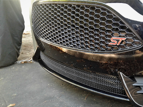

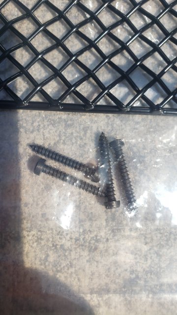

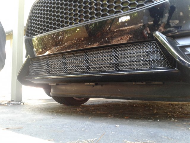

Alright, I finally got around to installing the Zunsport lower I ordered from Ron at Whoosh. As someone else mentioned somewhere, the screws that attach the Zunsport to the oem plastic insert are too long. The upper screw just touches my Whoosh V2 and the point of the bottom screw would end up 1/4" into the V2. I ended up using some strong black zip-ties to attach the Zunsport to the oem insert and snapped the assembly back in. The fit is pretty good and the zip-ties are hardly noticeable. Sorry for no pics, it's dark out, but what Ron has shown on his site is about all there is to see here. Being that it's this or a do-it-yourself fabricated set-up, I'm fine with what I've got and how EZ it was once I settled on the method. On to the next project...ensuring my Spec-D tail lights are adequately sealed from moisture(y)
212
112
Phoenix
#64
Additional thoughts: With the much thinner core of an oem fmic, you might be able to use the screws sent with the Zunsport lower. Shorter screws may be an option, but the lower ones would still contact an aftermarket fmic being that the eom insert sits flush with my V2. I did look at installing the grill without the oem insert, but zip-ties were a no-go. The vertical slats are recessed too far and the grill sat about an inch off of them when it's border contacts the bumper opening.

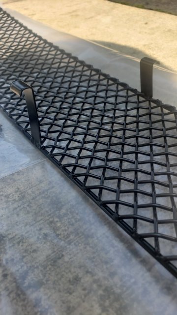

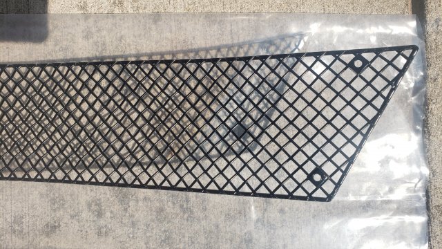

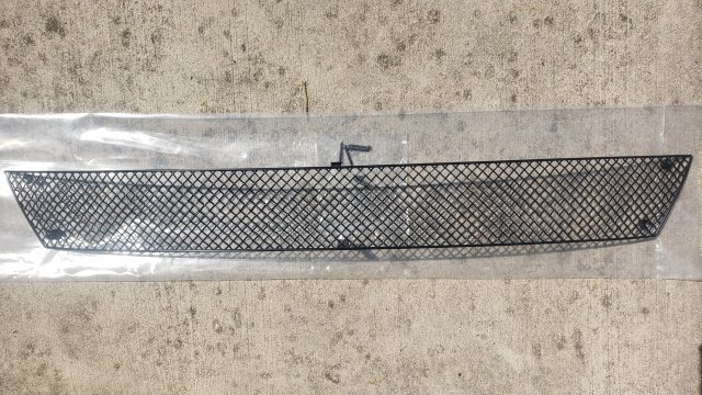

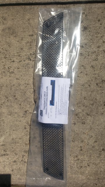

Unboxed, up close and personal.

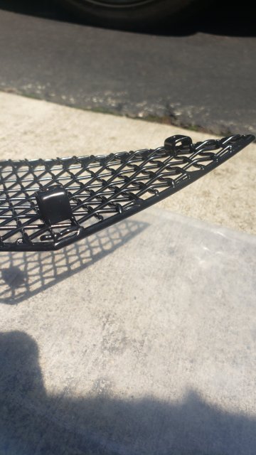

well, I installed mine, but have not taken pics.... evidently, there is still an issue. if I use those long two center tabs, the grill is pulled in more than at the sides. Grendlehop18, I see the zip ties. Did you not use the center tabs?
212
112
Phoenix
#75
The 4 screws that came with the Zunsport lower are meant to attach to the oem plastic insert. Problem was that they went through and made contact with my V2 end tanks. Now that I'm thinking about it, perhaps I can use the screws in alternative locations:unsure: I''ll need to look more closely at everything (instructions/hardware) later when I'm off work.
you may be able to just shorten the screws or use a shorter self tapper

The 4 screws that came with the Zunsport lower are meant to attach to the oem plastic insert. Now that I'm thinking about it, perhaps I can use the screws in alternative locations:unsure: .
I emailed them and you would swear I was talking Latin to them....they could not understand what I was asking. I was wondering if they were supposed to screw into the permanent, vertical slats since I removed the horizontal piece, but it must be one of the two....I am also wondering if they can make it to the vertical slats. If not, something like a super-small SS wire cable could go from a 10/32 machine screw to the vertical slats.
3,980
4,093
Thread Starter #79
they are not
it's designed to screw into the plastic OEM snap on grill section. The screws do not need to bottom out but just hold the grill in evenly when installing.
Once you have it positioned, tighten the self tappers just until they touch the grill. Only tight enough to not allow it to move around
