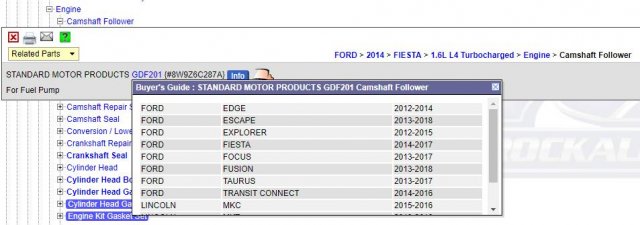

according to Rockauto, this cam follower is share among various Ford models, but i would hesitate on Standard Motor Product brand.
Ron, how much shipping to Canada? I rather get an OEM item
depends if you want it in 3 days or 12-21 days
if you need specific shipping quotes about ordering we prefer email or messaging - thank you
we always have these in stock here
