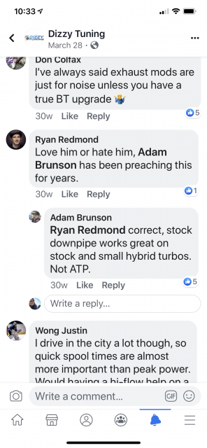

With the stock turbo, catless or high flow downpipe is not necessary as it is not a restriction for the stock turbo application...you don’t “need” to change the downpipe to run the hybrid turbo. Per dizzytuning, there only very minimal gains to be had power wise with an aftermarket downpipe when used with a hybrid turbo.

Where can I read more about Dizzy results based on each component changed.
