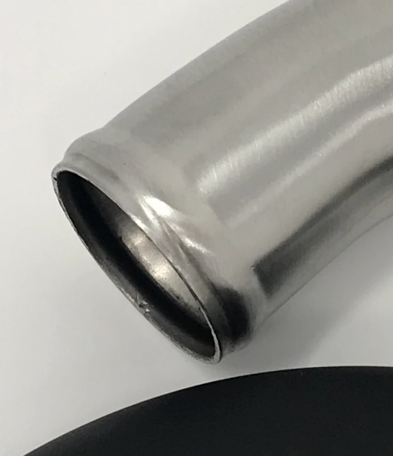

I've been a Manufacturing Engineer it automotive since 1982 and mainly work in Exhaust and Fuel system components for the Major automakers. As a result one thing that stands out on the Whoosh pipe is the missing and poorly performed Hose beads at the tube ends. The purpose of these beads is to insure that the hose won't pull off if there is tension placed on the hose. So I have to give Woosh a D- on those beads, they will have zero pull off resistance. I strongly suggest that everyone installing one of these pipe tighten the hose clamps really tight. BTW, simple pressure inside the tube can act to blose the hose off if the clamp slips. If you take a 1.5 inch diameter pipe and run the numbers a pressure of just 14 psi inside that pipe and produce 106 lbs of linear force on that hose connection.

The bead looks fine to me. I'd say by this picture it's a 3/32nd bump. Maybe the first batch were not rolled as good. And since I guess those are made in China, I highly doubt it would be worth the investment and floor space for Ron to buy a bead roller. In any case, he could ask for a revision to the manufacturer and increase the size of the bead.

Over 1000 of these pipes have sold and never a single one returned for bead roll issues
Have you tried one of our hot side pipes?
The pics shown in the first post are from the very first group offered in 2018. Since early 2019 the bead rolls have actually been improved and we now offer it in 3 finish options

Understand my viewpoint. Any of the major auto manufacturers would refuse to accept product with the current bead, what they want and expect is the bead seen on the Ford part. I am simplly pointing out that if Whoosh wants to match the quality of the OEM part there are machines and tools available that are designed specifically to do this and on the used market the machines are relatively inexpensive. I am also pointing out that the current bead offers near zero pulloff resistance and anyone using these tubes need to compensate for this by tightening the hose clamp as tight as they can.

The part could definitely be better.
The OEM part is definitely built better. I'm not going to say it's a bad part, because I haven't compared it to the other aftermarket ones. I also have the first generation of this part.
I have my clamps on as tight as possible.

I frankly don't understand the need to be correct and make a point of this hot side pipe.
Our newer version has more pronounced bead rolls than the Mountune equivalent at $50+ less in cost. The early version has bead rolls exactly like the Mountune part.
We've tested our pipe at 29-30psi for months of dyno and track time on Wesley's whoosh hybrid Fiesta which never once blew off a hose connection

I have this pipe on mine and never once had an issue. The pipe feels like its heavier then the stock pipe and I definitely have not had one issue at all. What I see here is mostly people wanting to nitpick a part that doesn't need to be nitpicked. If you guys don't like what is offered buy the more expensive piece move on and keep your mouths closed. I went with this pipe per reviews and quality and definitely not upset i did. I have purchased a few parts off of whoosh and haven't had one complaint about his parts. I like the fact that they're quality parts at a budget friendly price.

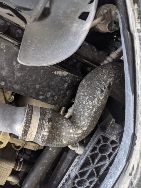

I was under my car the other day and noticed one of my boost tubes was pretty squashed. Is this something that would restrict the airflow enough to make a difference, even on the stock turbo? Would a replacement be noticeably better?
Absolutely * total bottle neck. Imagine trying to suck/push a golf all through that mess.
