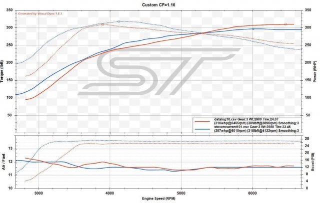

Here is a direct comparison of my max effort 29psi whoosh setup on aux fuel vs my buddies s280 build with a tubular manifold and full fuel system. On 93 it’s kinda of a wash but on corn he got me beat by alot
Blue line is whoosh
That graph is 93 or E30?
Blue line is whoosh
His pull starts later than yours he needs to go back and do another pull starting at 2500 rpm for it to be an accurate comparison otherwise its just not and its useless data.
Blue line is whoosh
What's going on with your whoosh not hitting peak torque until 4100 RPM? I thought other dynos I've seen have it peak closer to 3400.

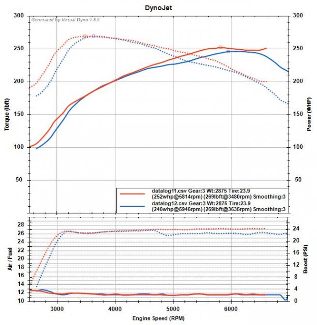

I think I got the VDyno dialed in better, trimmed out that spike at the end there where redline limiter dumps. Someone told me what smoothing was best but I forgot already. Scratching my head trying to think what I might of did on the blue pull to have it fall off a little. I want to try and find out what a more accurate wheel diameter is for my set up 215/40/17 Dunlop Direzza ZIII
*edit-found the Direzza info on Tire rack

Will post up fresh vdyno of final 93 revision, one benefit is my gas mileage has gone up about a mile per gallon and that's not taking it easy at all. Pretty neat while 2nd will completely smoke the tires if I let it.
A little worried I wont be able to datalog E30 in 3rd gear due to wheel spin. The thought of doing it in 4th...id prefer not to unless I can find a much safer or off road place to do it

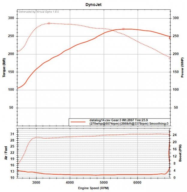

Final revision. I looked up the curb weight of the 2019 and weighed myself, adjusted the wheel diameter to match. I am liking it. Thought torque would be higher BUT E30 is about to begin and I will get some torque there :whistle:
2
Titusville

Hey how did the E30 tune go? Were you able to get 3rd gear logs or did you have to go to 4th?
Yes 3rd gear was doable once the tires were warm. I ran out of fuel at the top end on E30 and didnt even get a revision for it. Just advised we'd be staying with the initial tune and injectors would be needed for more. Its def stronger. On Edyno torque was the same and HP was up by 10. I imagine that those numbers arent accurate as I know torque is higher by feel.
2
Titusville
