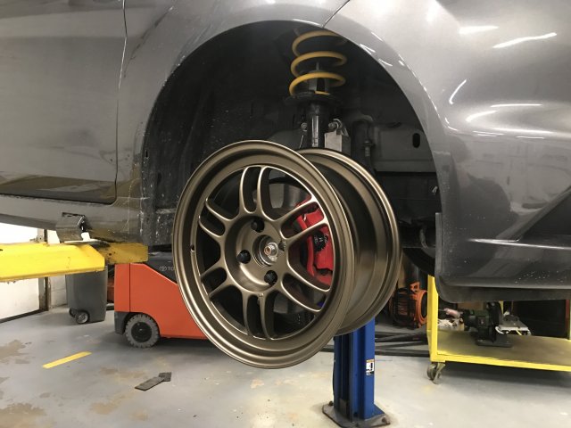

Thread Starter #29
Production is finished and the wheels will be headed over from Japan soon!
We are 4 - 6 weeks out from delivery.
Half of the pre-order slots are sold.
OAKOS Automotive
OAKOS Automotive
834
114
Sterling Heights, MI, USA

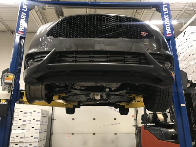

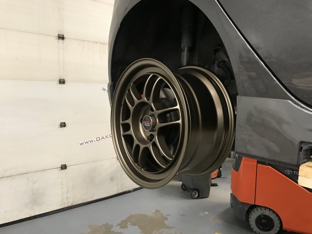

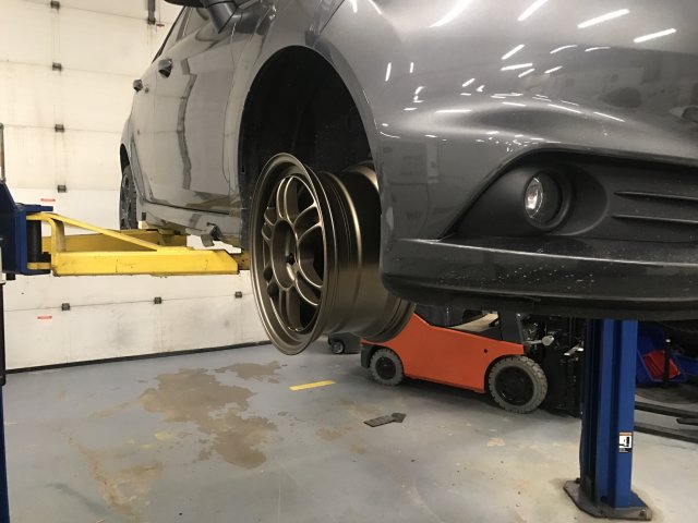

Thread Starter #32
(plz excuse our dirty car)
Here they are!
Tested front and rear and looking great. No concerns with clearance anywhere.
These are now in stock and ready to ship! Shoot me a PM or email about ordering with forum pricing.
Pre-orders have been shipped as well.
