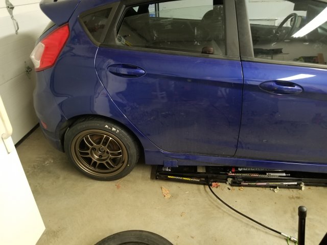

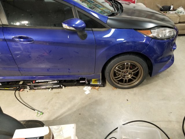

I'm rebuilding a salvaged car so I don't have great pictures yet. Will take more once it's inspected and on the road. This is stock suspension with 205/45-16 re71r tires. I have ISC coilovers that I have yet to install. If you look in the builds sub-forum you can follow my thread there for more updates.
View attachment 38156 View attachment 38157
Hey we are also rebuilding a salvage car that will be getting the 16x8s when its done!
