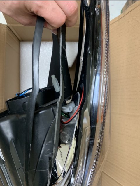

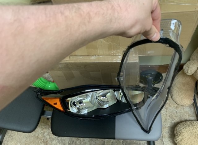

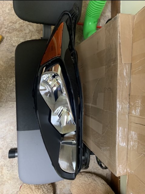

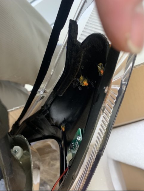

Alright so Spyder headlights are straight garbage for retrofitting. DO NOT, I repeat DO NOT waste your time or money on Spyder for a retrofit.
See below.
The bezel is glued to the lens, there is no bulb for the park light / DRL in the side marker spot and is just a cheap LED glued to a bezel.
Prying it open broke several weak seams and resulted in a disaster.
Meanwhile, this is the DEPO set. It is exactly set up like OEM in every way, from the wiring to the molding of the lens and rear of the headlamp. Look how cleanly that opened up? Huge different for not much more money and well worth it. Those of you following along, take note. DEPO replica or OEM only.

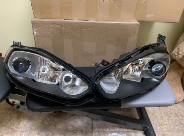

Thread Starter #54
oooooo me likey
Your will look like this!
Your set I’m fighting on getting a replacement as one of the tabs was broken on the inside. They are being more than difficult.
I can repair it I just don’t want too send it like that if i can get a replacement one in a reasonable time frame.
