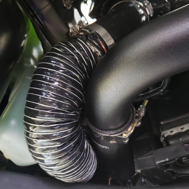

That's the hose that came with mine, it feels quality enough and now having gone in there a few times it seems pretty well protected from water.
Looks like a random hose they had lying around in the back. Was it that beat up when you got it?

Overall I'm pleased with the tune and was able to get the airbox installed in like 45 min. I was wondering if the cloth style tube would help against hydrolock in the event there was some water I couldn't dodge.
That's the point of it. If you didn't get a porous hose, someone screwed up.

I use 2.5" brake duct hosing for mine. Its significantly cheaper, had spiral wound wire within to reduce crushing it and lasts a LONG time.

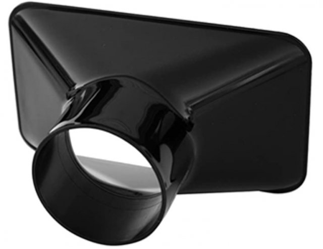

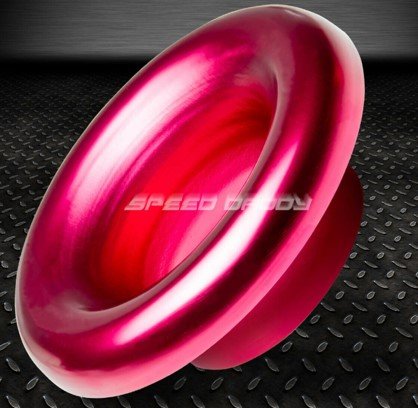

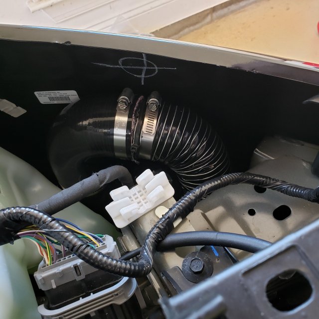

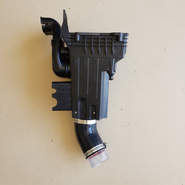

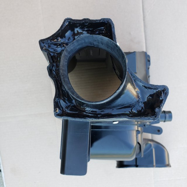

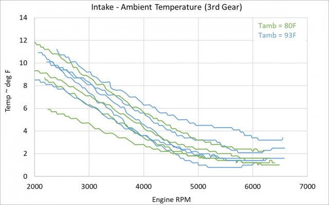

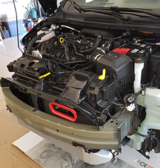

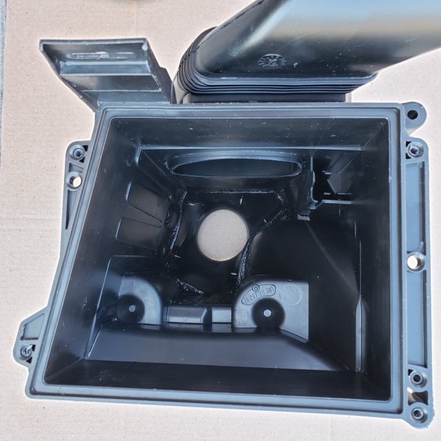

I ordered the Cobb Stage1+ before doing a lot of research, so I have the Cobb Intake that utilizes the OEM lower box. I added a Velossa Tech snorkel. The actual intake flow path looked very restrictive to me, so I checked the pressure loss and it was terrible (Baro-Intake from logs). To reduce loss, I had an idea to open the lower box and plumb to the front... actually before learning of the ST200 and other similar designs.

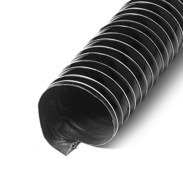

I believe the hose in question is 2.5" ID. TyphoonFist's 1st link is 3". I got a 1m length off ebay delivered for $21. It's pretty high quality high temp silicone coated hose, used a lot for brake ducts. For those that like to tinker, want a ST200-type cold airbox, and don't have one or similar, here's what I did to use up some stay at home covid19 time. Don't want to redirect business from Ron, he has the ST200 box. He also has the fog light delete, I fabricated mine from a $10 (delivered) aluminum bell mouth from ebay.
I am an engineer, rocket/jet/gas turbine industry for 35 years. I am enjoying fiddling with my car, so thought I'd share. I actually have quite a bit of comparisons of pressure loss and temp rise for various intake configurations. I'm very happy with where I ended up. I don't think it can be improved any further relative to intake pressure loss and temperature rise. That's not to say there aren't others very similar, I expect some are.
Now that I have been at this just a while with the car, I will always buy from Ron, unless he doesn't have it and I need it, or as in this case if I want to make it myself.
