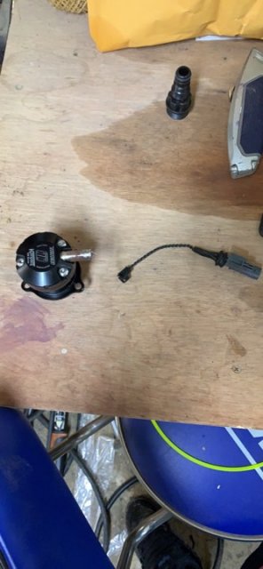

My SECOND em bov has failed on me. The first was warranted by Turbosmart due to sticking open. Now this one is sticking closed (assuming electrical failure). I’ll be switching to vacuum operated.
You wouldn't happen to have any of the ones that failed just laying around would you or did they make you return them? I was taking mine off to do some maintenance work on it and the harness/solenoid snapped. I barely even moved the thing. Name your price if you or anyone else has one laying around.

Any better pictures of the connector that broke off? How much wiring is there left or none at all?

The connector could have potentially snapped or glued back on but the prongs on the valve were physically broken off the solenoid. Inspection of the soldering on those prongs showed to be of poor quality and it all seemed very very flimsy.
Mine broke off in the same spot. I was able to find a replacement one on turbosmart's website. Hopefully it gets here soon.
