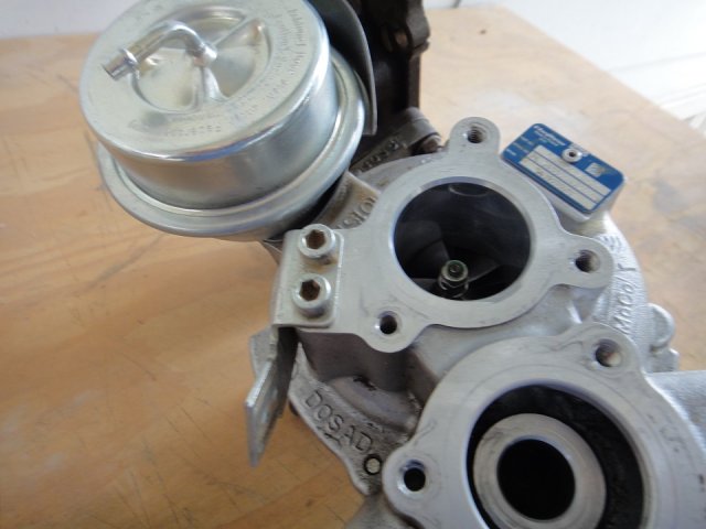

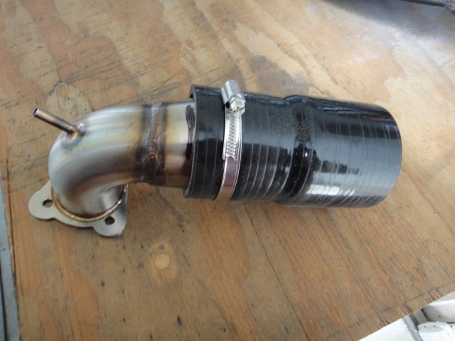

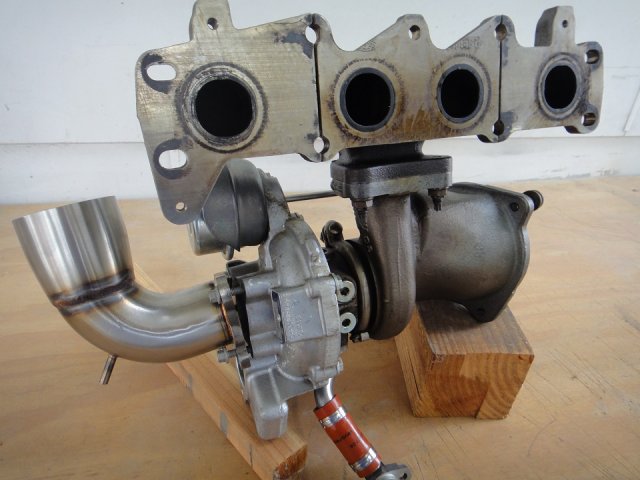

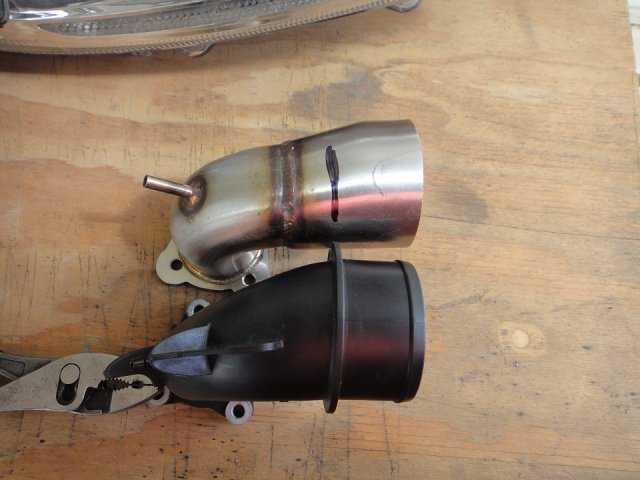

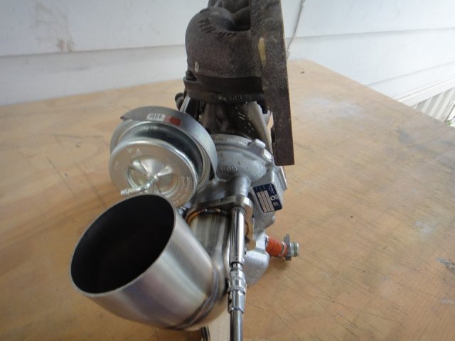

I received my Whoosh Turbo Inlet Elbow today.
First let me assure you that there is enough room for a gasket if you are so inclined.
Sense I am not going to use a gasket of any kind, I have decided not to make one.
I just happen to have an extra turbo so I will show you some things off the car (it's easer to see).
Note the bracket next to the inlet.
Since there is some play, you must make sure the new elbow sets flat on the inlet and NOT on the bracket.
Start all three bolts (original OEM hardware) before you tighten any of them.

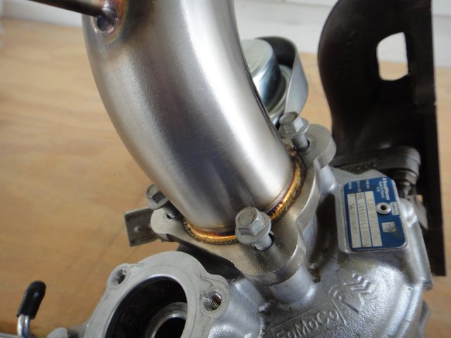

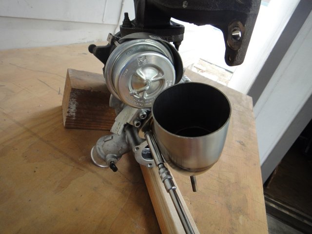

Now we will switch views so it is close to the way it is in the car.
Next snug up the bolts, you will note that the bolt closest to the engine is very close to the pipe.
However, here you can see that I am using a 1/4 drive deep 8mm socket and it clears just fine.
Tighten the back side bolt first, again making sure that the elbow is not on the bracket.
When all 3 bolts are tightened, you can see here (almost impossible in the car) that there is NO gap.
Dave

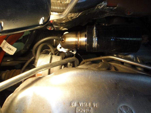

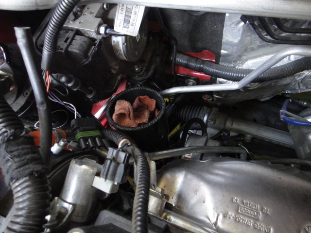

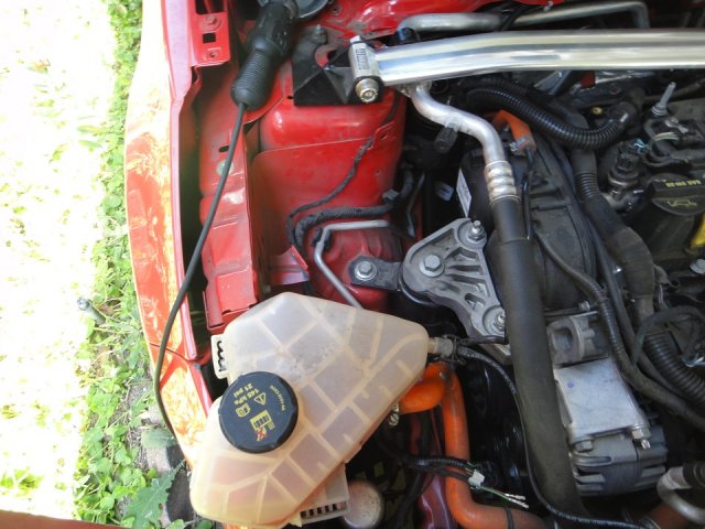

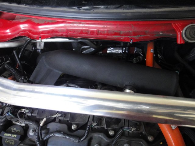

I installed the Turbo Inlet Elbow today.
First I might suggest you move the water tank to gain additional access.
Next you might want to mark the new elbow to know how far down to push on the silicone coupler.
Then I installed the coupler and I positioned the clamp to be at the same position as the OEM.
Don't forget to reconnect the little hose on the elbow.
I hate those spring clamps but I would prefer to put it back on than not.
Now bolt the new elbow in.
Next I installed my Ramair Crossover Pipe.
Last I have to put all the remaining parts back on but I won't bore you with all that.
Dave

Sorry for the two-months-later bump, I just wanted to ask - it appears from these photos that the diameter of the high-flow inlet is the same diameter as the inlet on the turbo itself, is this correct? Therefore I would assume that the stock plastic inlet is actually smaller than the inlet on the stock turbo, right?
