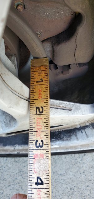

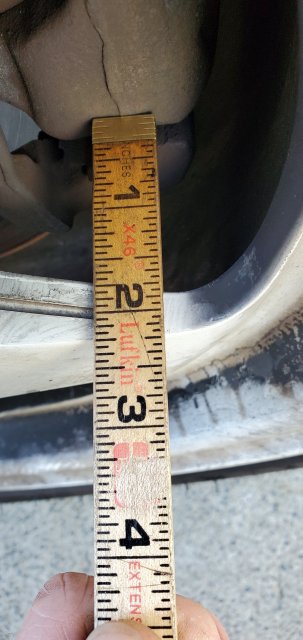

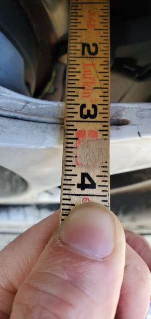

I've been eyeing the Whoosh 285mm kit for a while now, but I'm worried they won't fit under my 15" Rota Slipstreams. I saw Lays mention using them with 15" TD 1.2s, but wondering if anyone else has any experience with the kit on 15" wheels.
14,860
7,322
#39
The 15x8 TDs are ET35, so unless the Rota's spokes radically curve inwards, or are very thick, that kit should work.
114
167
Durham, NC, USA
#40
They don't appear to curve inwards too much, at least from what I can see.
Took some measurements from the face of the rotor and the front and back of the caliper. Because of the angle of the camera, the measurements look a little bigger. Does anyone have measurements for how much wider than stock these calipers are?
Rotor ~2 5/8"
Caliper ~1 1/16" and ~1 5/8"
