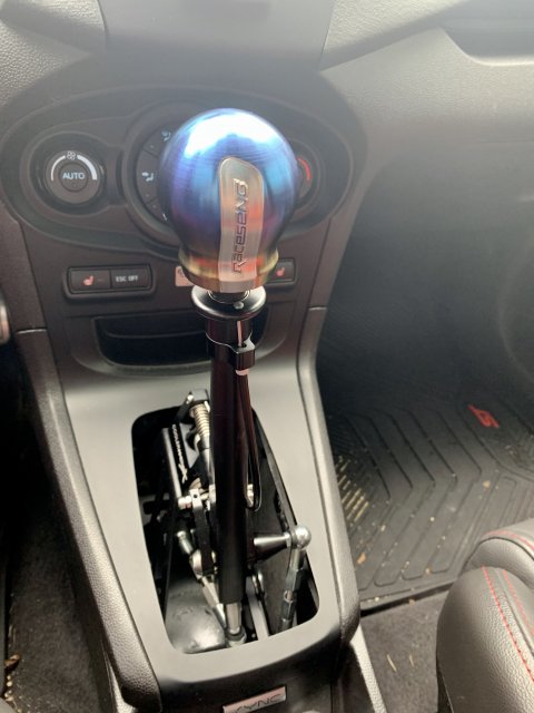

Popped this Raceseng knob on today. The extra weight over the Cobb knob really smooths out the shifts on the Coolerworx. Time will tell if I continue to like it but so far it's amazing.
It’s an M12x1.5 correct?

Looks great ! Been wanting to switch the knob also but feel like the shifter will fall apart quicker- I know thats stupid and doesn't make sense, but feel like its just a matter of time
I don’t know why it would but definitely your call. I couldn’t stand the feel of the coolerworx knob. I’m a round knob kinda guy. I was using a Cobb knob, which has been my favorite for years on many different cars.
