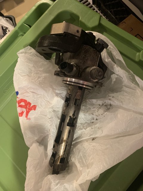

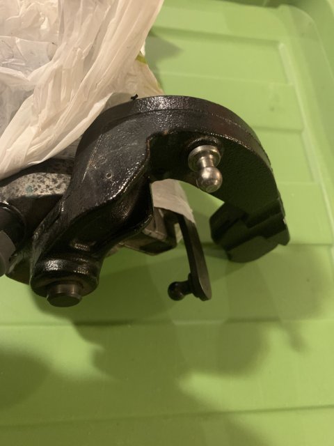

So I'm trying to pull the shifter arm assembly out. It gets all the way to the end, I assume and it's getting hung up. My inexperience has me nervous. I have it neutral, I've tried 3 times without success, fearful I won't be able to get it back in.
