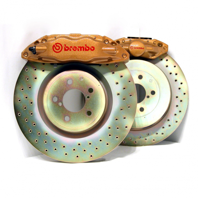

Here are 02-17 WRX STI calipers. Also Note that EVOs use the same calipers:

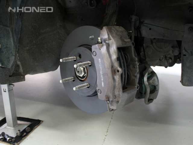

Porsche 986 calipers commonly used on civics:

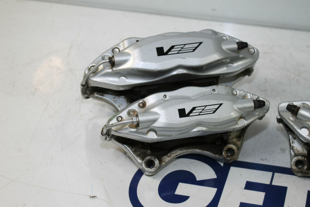

Another common swap is the CTS-V caliper swap:

I saw that Porsche caliper swap on Gears and Gasoline EK9 Civic video. Pretty cool that they work
