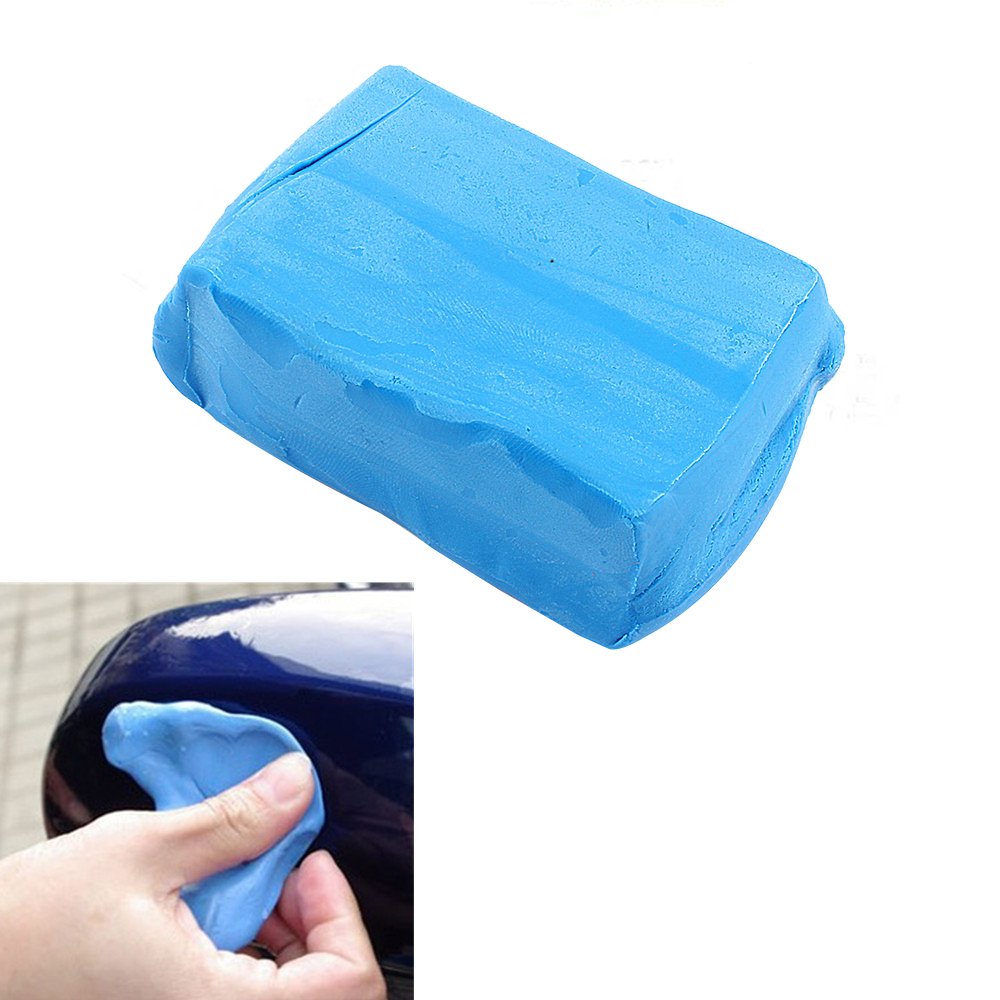

You guys recommend clay baring before polish or is it not necessary?

Honestly most clay bars are the same. The difference is the color, which equals the grade the clay pulls the contaminants from your paint.
The higher the "grade" the more it will pull contaminants... HOWEVER, it's a lot easier to marr the paint with a higher grade clay. I wouldn't use a heavy grade clay unless the car is in very bad shape.
That being said.... I don't think I'd buy something called "magic clay"... you can get Chemical Guys or Meguiars clay on Amazon. That would be a better choice.
